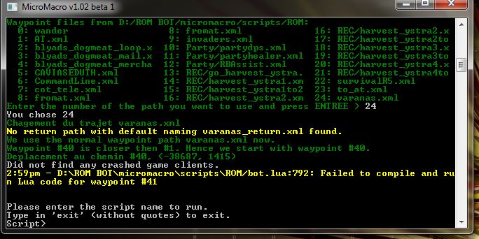

#7 Post by noobyone »
Sorry guys I am realy busy IRL, so I dident work on this since days.
THIS IS ON DEVELOPEMENT
They are still a lot of changes to make.
I just share it for those who wants to help, they will be no support until its finished and posted in : " Userfunctions, waypoint scripts, etc."
So what I already did is:
1/The bot start a varanas central place
and make malentina survival game (rock 5) -----> Use "SurvivalR5"
http://www.solarstrike.net/phpBB3/viewt ... t=survival
In the SurvivalR5 waypoint file you just have to write the option to load "cot_tele"
	--=== Rock5's version ===--
	--===  R5Version 2.52 ===--
	--=== User Options ===--
	When_Finished = "cot_tele"
2/ he does malentina course of terror (lisa) -----> Use "cot_tele"
http://www.solarstrike.net/phpBB3/viewt ... lit=terror
After COT you load a new waypoint file to go to AT, for this you have to write the option in the "cot_tele" file, my file is "to_at"
<?xml version="1.0" encoding="utf-8"?><waypoints type="TRAVEL" >
<!-- Rock5's Course of Terror waypoint file with teleport -->
<!--   version 1.72 . Thanks to lisa for original script  -->
<onload><![CDATA[
	When_Finished = "to_at"
		-- "end" to end script, "relog" to log next character and "waypointfilename" to load that waypointfile.
	CharList = {}
3/ He goes to AT --------------> use file "to_at"
to_at.xml

I changed some things: to be sure It works for everyone I chosed to use snoop from stascilia instead of the teleport skill.
I have some probs "again" :s
<!-- # 40 --><waypoint x="-38687" z="1415" y="-1">
	player:target_NPC("Snoop");
   ChoiceOptionByName("Fort d'Obsidienne");
   sendMacro('StaticPopup_OnClick(StaticPopup1, 1)';)
   waitForLoadingScreen()
	<!-- # 41 --><waypoint x="-20460" z="6507" y="-169"> 	player:target_NPC("Snoop");
   ChoiceOptionByName("Varanas");
The problem is the character dont target Snoop at waypoint 40. So he dont teleport and fail to compile waypoint 41.
I dont see what i did wrong.
Re: Mini games for rerolls all in one
#15 Post by rock5 »
You can't have semicolons (;) in the brackets like that,
It's ok if it's in the quotes eg.
or get rid of it altogether
sendMacro('StaticPopup_OnClick(StaticPopup1, 1)')
noobyone
Joined: Mon Feb 27, 2012 5:29 am
#16 Post by noobyone »
Yeah that was the problem.
Thanks Rock.
