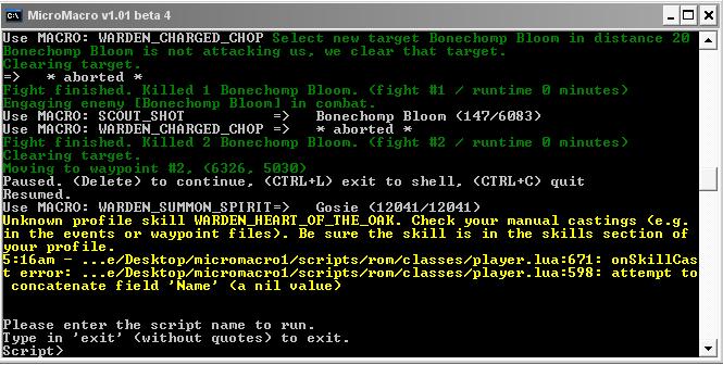

BillDoorNZ
- Posts: 446
Re: Need help to build a custom Warden/scout farming
the
is wrong, in that you do not have the "WARDEN_HEART_OF_THE_OAK" skill in your skills section. Neither do you have the "WARDEN_SUMMON_CHIRON_THE_CENTAUR" skill in your skills section.
BillDoorNZ wrote:the
is wrong, in that you do not have the "WARDEN_HEART_OF_THE_OAK" skill in your skills section. Neither do you have the "WARDEN_SUMMON_CHIRON_THE_CENTAUR" skill in your skills section.Code: Select all
onskill <onSkillCast><![CDATA[ if( arg1.Name == "WARDEN_SUMMON_SPIRIT_OF_THE_OAK" ) then player:cast("WARDEN_HEART_OF_THE_OAK"); player:cast("WARDEN_SUMMON_CHIRON_THE_CENTAUR"); end ]]></onSkillCast>
like this??

BillDoorNZ
- Posts: 446
I would assume so - yes.
without having a similar setup its hard to test, but based on the screenshot you provided and reading through the code, that should fix it.
now in this profile. if i don't have pet summoned. my character summon "WARDEN_SUMMON_SPIRIT_OF_THE_OAK" the get "WARDEN_HEART_OF_THE_OAK" and summon "WARDEN_SUMMON_CHIRON_THE_CENTAUR" but my problem now is when my "WARDEN_SUMMON_CHIRON_THE_CENTAUR" are summoned.. my character not summoning "WARDEN_SUMMON_SPIRIT_OF_THE_OAK" the to get "WARDEN_HEART_OF_THE_OAK" and "The pet by your side cannot give you this power" will show up in my client

<onLoad><![CDATA[
runicthorn()
startGMDetect()
registerTimer("summon", minutesToTimer(15), function () player:cast("WARDEN_SUMMON_SPIRIT_OF_THE_OAK") end);
]]></onLoad>
<onDeath><![CDATA[
-- player:logout(); -- logout
]]></onDeath>
<onLeaveCombat>
runicthorn2()
if 50 > (player.Pet.HP/player.Pet.MaxHP * 100) then
player:target( player.Pet )
player:cast("WARDEN_ELVEN_PRAYER")
catchCavy()
</onLeaveCombat>
]]></onSkillCast>
