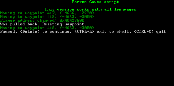

Hello, Im just starting to use rombot, and I'm having a bit of a problem. I'm trying to make use of the script provided below (old I know), from this thread: viewtopic.php?f=27&t=4342&p=43785&hilit=mist+emerald#p43785
However, every time I zone into barren caves micromacro says: https://www.solarstrike.net/phpBB3/ and my character endlessly tries to run through the wall in the complete wrong direction. Based on the message it given in micromacro it would seem it thinks it's still in Howling mountains and is trying to reach the coordinates of the previous waypoint. Is this correct? If so how would I go about fixing it. Thanks.

Re: Was pulled back. Resetting waypoint fix.
That appears to be what it's doing. I have success there using the GoThroughPortal() command. It's a userfunction and if you don't have it, you can get it here: http://www.solarstrike.net/phpBB3/viewt ... 916#p37916
The waypoint listed for waypoint 18 you may never reach. Try making your waypoints for 16, 17 & 19 like this (just get rid of wp18 all together):
Also, I'd be careful about using fly() because all it will take is for a GM to see you flying inside that instance and you'll get a ban. There are several places I used to use it all the time but I've been hit on it multiple times in different locations so I try not to use it any more.
<!-- # 16 --><waypoint x="-4649" z="-2909" y="54" tag="enter" type="TRAVEL"> player:dismount(); </waypoint>
<!-- # 17 --><waypoint x="-4656" z="-2970" y="38">
if player.Mounted then
player:dismount();
__WPL:setForcedWaypointType("RUN");
GoThroughPortal()
yrest(2000)
<!-- # 19 --><waypoint x="1765" z="1371" y="249"> </waypoint>-
